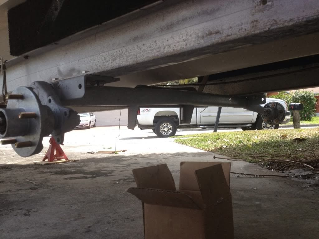

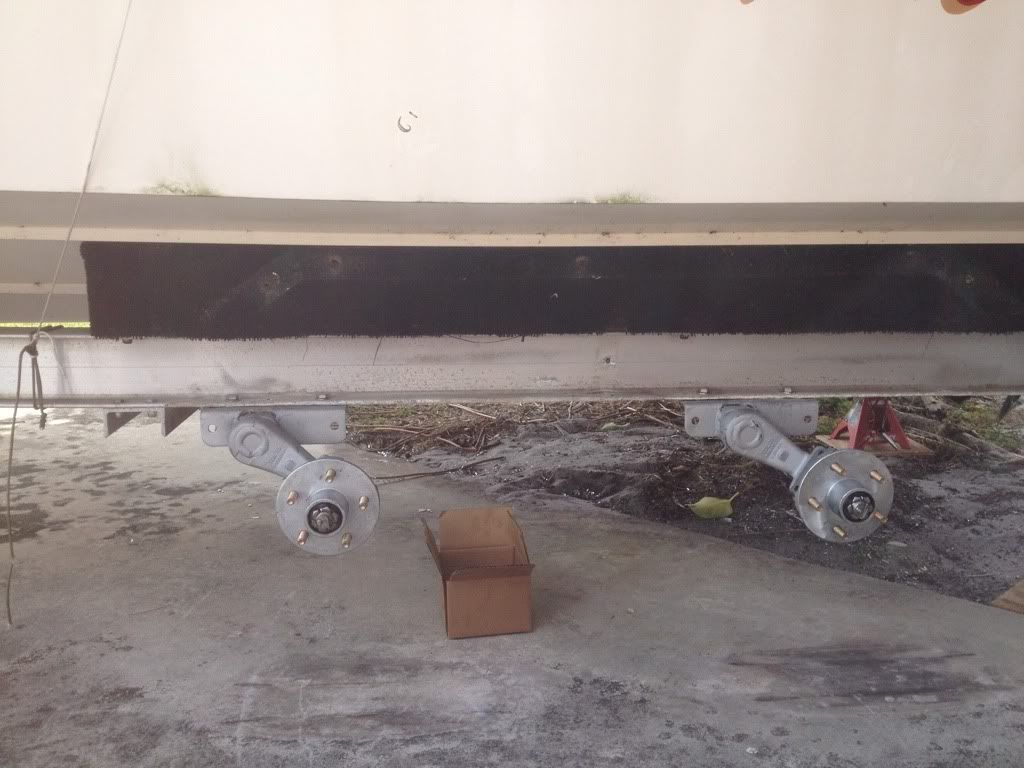

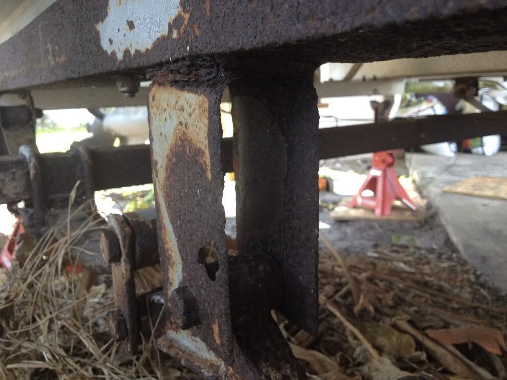

You picked up a 261? Congrats. Your Old 231 will have a Alexseal on topsides in about 2 weeks! I'll send pics. Couple questions, 1. do you have a source for the rubber gasket material for the windshield and 2. a source for original style MAKO231 emblem for the stern, and 3. a source for the aluminum USCG capacity plate for the center console? Thanks, wish I could figure out how to look at an post pictures on this site...would love to see your project! Hope all is well.

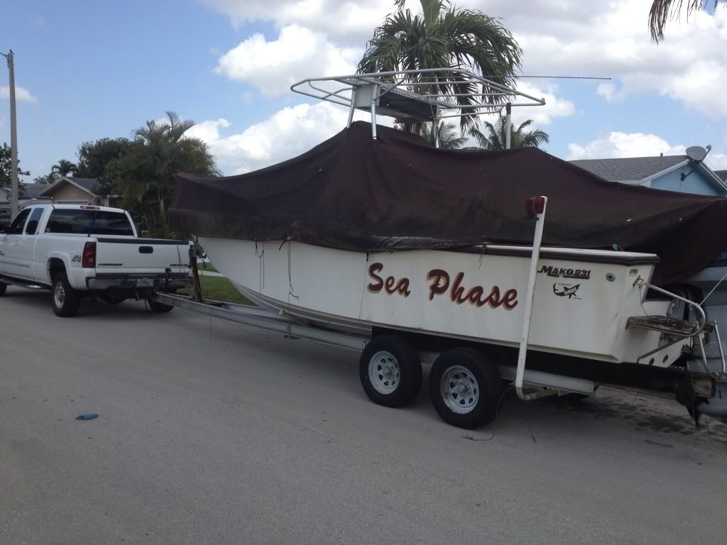

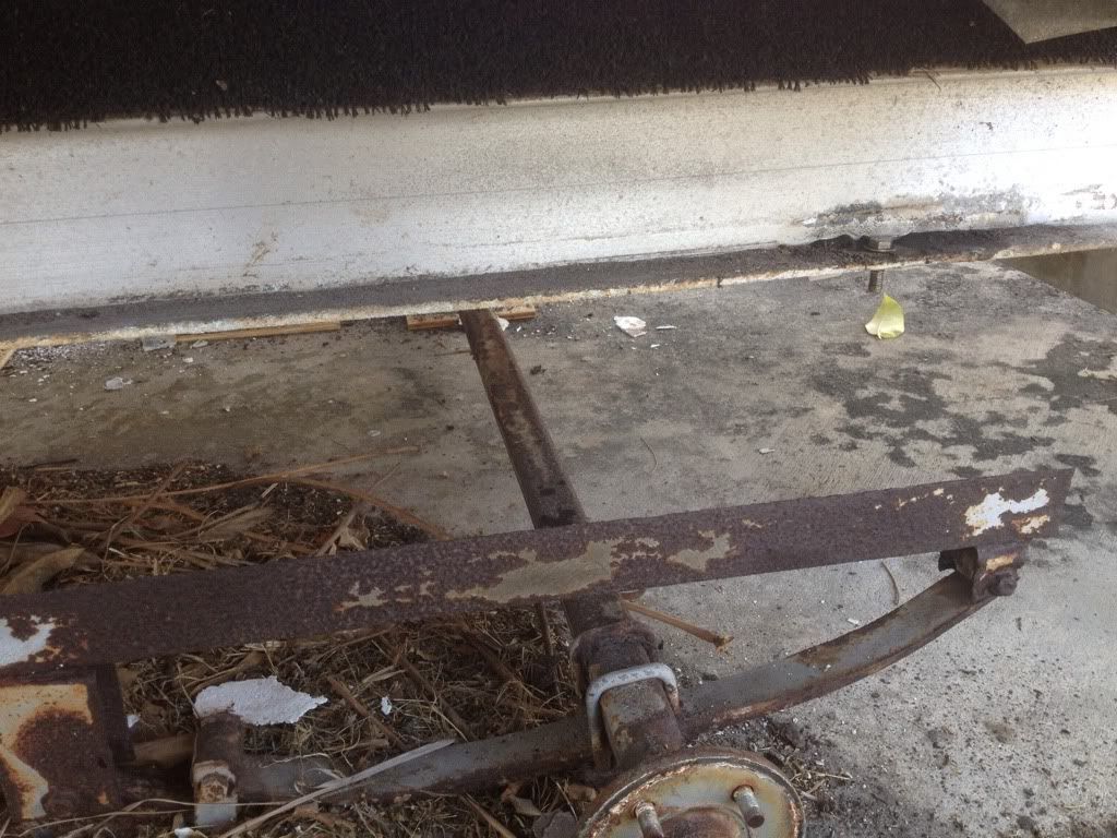

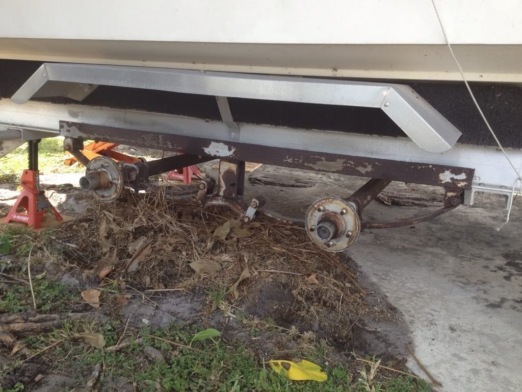

Originally posted by 231Mike
Progress has begun! Had to rebuild the trailer before the boat could be moved from the original owners property.
Hooked up and ready for a new home
Time for a wash and wax
